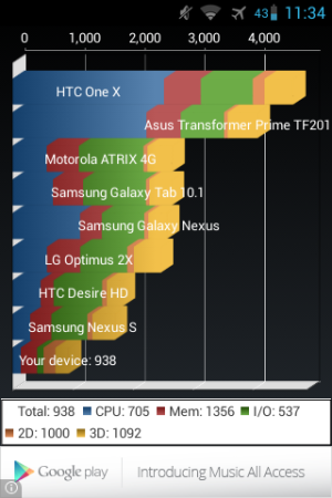

added armv6k compile flags since the MSM7627 is capable of handling the added instructions.

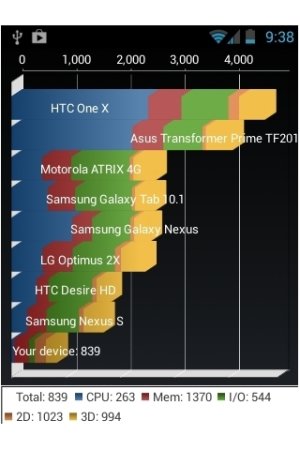

it seems a bit faster. new quadrant score from JBC, PAC is slower on CPU tests for some reason.
