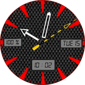

If this is still of interest...
I made a watchface that will allow access to the timer with one tap on the watchscreen (a tiny bit more convenient than double pressing the home button). Search the Gear App Store for Lava A/D; it is free. Tap the digital clock to display the timer.
