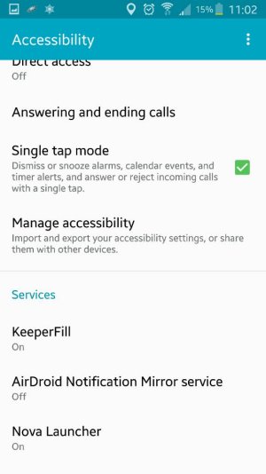

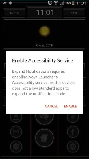

I have a similar issue, but it's definitely not Google Now related because I don't use it or any of its widgets. So here's what happens:
I'll be in an app...any app...and I'll very randomly get the pop up that says Nova Launcher isn't responding and am given the option to close or wait. Doesn't seem to matter which I choose, because I have the same problem once I exit the app that I'm using. I go back to my home screen and everything works just fine except for my notification window.
When I try to pull it down I get a message saying that I need to enable it in Accessibility Services. 1457021556807.jpg
But when I get in there, that option is already turned on. 1457022027057.jpg
The only fix I've found so far is just to restart my phone. This isn't a common occurance...happens like once every 2 or 3 months, but it's still annoying as funk.
I'm guessing it's just a glitch or hiccup that happens every now and then, but not an actual issue. Of course, if anyone knows of a fix to make it stop, I'm not gonna complain.
When I try to pull it down I get a message saying that I need to enable it in Accessibility Services. View attachment 218430
But when I get in there, that option is already turned on. View attachment 218435
I would see that exact same thing with Nova.
