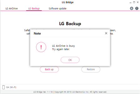

I have a problem with LG Bridge. I am now running Marshmallow on my LG G4. I went to see if there was any other updates for it using LG Bridge. I attached my phone to my computer via USB. When I click check for update I get this message:11.49.25 19-12-2015.png
I wondered why I am getting this message?

Hi, I know it's been a while since your post so you may be sorted by now. In case you're not, I'll summarise what I've just discovered:
I was having the same problem & noticed this post whilst I was looking for a solution online (didn't find one but cracked it on my own).
What the program doesn't make clear is that 'connect' is only for accessing your phone's content - DO NOT PRESS 'connect'
1. You must connect by USB, not WIFI
2. Select MTB for the USB connection from the drop-down notification - LG Bridge should launch on your PC
3. Now back-up and/or check for software update
Seems to me that the 'connect' option is tying up your phone contents, hence the 'busy' message. Hopes this helps you and/or someone else, as I was tearing my hair out!

Have a look at my post in the thread entitled: 'LGG4 won't connect to LG Bridge' just in case you're having the same problem as I was (particularly if, like me, you only normally hibernate your PC & don't shut-down)
Great. This worked for me and i am backing up my device at the moment. I have already updated my software to MM.
Thanks.

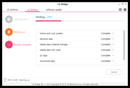

Other people on VZW say they cannot use Bridge either.. seemingly another thing US carriers don't want you to use. I don't use AirDrive myself, but I do use LG backup and the SW update feature. Speaking of somewhat shoddy software, the backup feature was partially broken after the upgrade to MM - it wouldn't finish the backup process unless I de-selected 'Personal data' from the list of data types to back up. The new version fixed that and complete backups are possible again.
One thing is still broken though: LG Bridge *locks* the file system on your PC while backing up, so don't try to open a new (file) explorer window while a backup is in progress - you have to click on 'OK' after the backup completes before you can navigate your PC storage again..
