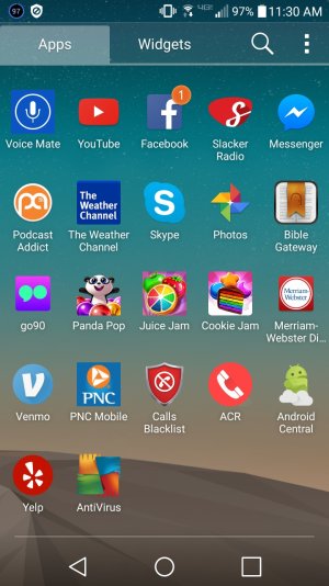

I have All Calls Recorded installed, and whenever I make or receive a call, it automatically records it. I also have Calls Blacklist installed, which blocks any unwanted soliciting calls. Or could any of these other apps that I have installed be the culprit?
The easiest way to test it out is to uninstall each app one by one, and see if the problem goes away after each uninstall.
Also, did you try Safe Mode? If the problem goes away in Safe Mode, then it certainly could be one of those apps. If the problem persists in Safe Mode, then it probably has more to do with the hardware or firmware, rather than any app you installed.
