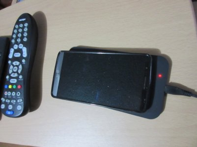

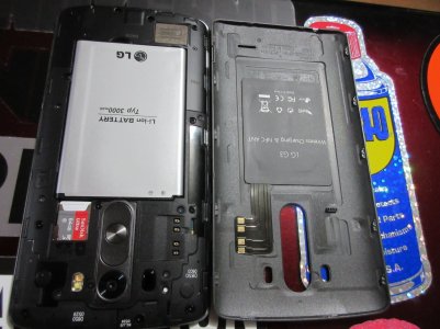

hey, i have the canadian model of the lg g3 from bell, the D850. bought the qi wireless on ebay and i installed the antenna on the back cover. laid the phone down and nothing. light on the pad stays red, nothing lights up. the 4 pins seem to match up. did i do something wrong? IMG_0619.jpg IMG_0620.jpg

Make sure everything is installed correctly and that the phone is positioned on the charger correctly. Often times you have position the phone a certain way for it to detect the Qi charger.

I had the same issue with my VS985. I fixed it myself. What I did was this:
Take off the back cover. Look at the pins on the device itself. I took a small screw driver and pushed the pins all the way over to the outer edge of the device. Now my pins make contact with the sticker on the back cover and my NFC and Qi charger work fine.

Thanks, That was EXACTLY my Issue. After trying TONS and TONS of diff ways to make it work that did the trick! Love my G3 this only makes it that much better.
