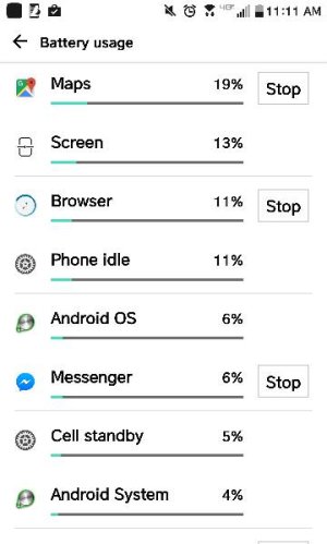

Here is my battery usage. With 25% brightness and 38% battery. I charged it yesterday around 3pm with light-moderate usage.
What do the "Stop" buttons mean along the right side of the battery usage screens, and what do they do if you press them? I know they turn grey, but what exactly in the app are they stopping?
