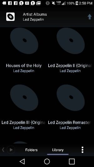

I go into artist and it opens the artists albums....that doesn't work for you?
No, that is something different.The album artist is useful if you have compilations. As an example if I have an album with 25 tracks, from 25 artist, using Artist there would be 25 different artists. If I use album artist, there would be one "various". When I play the album, each song would show the track artist. I am horrible at explaining things, but it is a personal preference. It seems to be good for people with large collections.

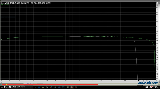

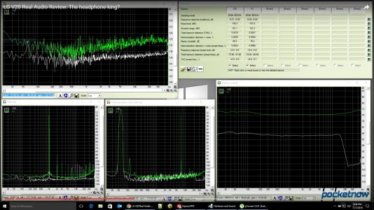

The V20 as it stands is capable of delivering a max resolution of 32 bits at 384 kHz. The frequency truncation you have brought up is mostly due to the DAC treating any slight excess electronic noise as distortion, and actively trying to compensate by cleaning out the sound. Yes, a quick firmware patch will & can address the issue if it makes any purists out there happy enough. The key is to be very careful with Synthetic testing, you don't want to introduce any eletronic noise especially to an overly sensetive system.
Pocket Now had quick video showcasing this issue:
But....that was not consistent enough to warrant calling the audio output quality a "placebo effect".The other THD spectrum testing was perfectly fine:
(bottom left corner frequency spectrum matched up with the Fiio K1)
The full video can be found below:
