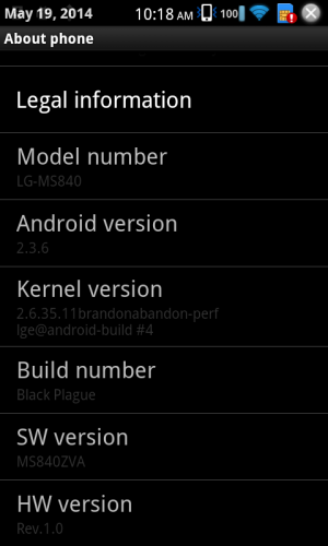

darn. for a second i thought it was either ICS or JB. sadly i note the system version to be 2.3 aka gingerbread. Anyhow, unless i can figure out how to make a bootable ubuntu thumb drive to install it, i am pretty much at a dead end. only other option is to have someone make and mail me a cd, which always runs the risk of it breaking.

official paperweight of a viper.lol. i flashed the homeless kernel with the plague rom and when my battery died, so did my viper. im not getting a new one.lol. good luck w/ developing everyone, and im glad i could contribute to the viper community.
