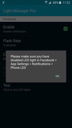

i tried Led Blinker, Lightflow and Light Manager
Light Manager is the only one that works properly, make sure that when you activate the led in Light Manager, you have to disable led in the app that you want to use the led for, if you don't, the led will still blink a blue light.
