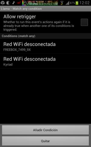

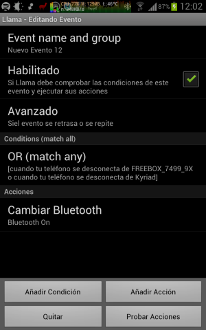

For example, this could work:
Condition:
OR (Not conected to home wifi , not conected to work wifi) (so you don't necesarily have to put a location condition)
Action:
Bluetooth on
Start your app
But this will work as you want only if you are always connected to wifi when you are at home and at work.

I have a condition in there for Wi-Fi but it won't let me Deselect location it says if condition (matches all)
Hi:
I don't understand your problem.
Here are the screenshots of the event, sadly it is half spanish:
The event:
The OR condition:
I put two random wifi networs.
yes, just the event.
Profiles are for managing system sound, ringtones, notifications sound, vibration, etc.
And with an event you change the profiles you created usually accordint to locatiion, but not necessarily.
