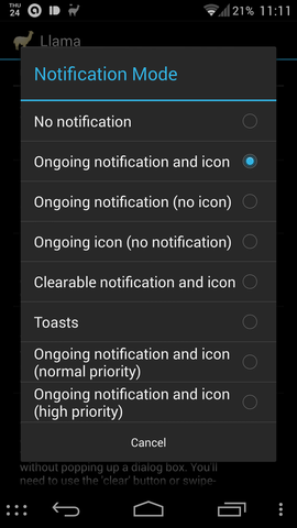

2. I don't have any "profile logo" in the notification bar...it's that normal? I searched in settings but I did not find anything like this! I saw that same colleagues have !
I'm using a Note 4 Android 5.1.1
You mean this?
yes that one! it's makr but still no Llama logo on the notification bar!
Make sure Settings > apps > Llama > notification is checked.
Ignoring the possibilities that something is broken (either the OS, Llama, or the hardware) or you set up the device to hide/silence notifications from selected apps, if you set up Llama notification to show and it doesn't, that means Llama service is being killed by the OS (i.e., your device does not have enough RAM for your use case) or by a task killer you set up (basically means the same thing - not enough RAM, but you have more control here. Better yet, stop using a task killer altogether). If Llama service is being killed, no surprise your events are not firing when you want them to. No point kicking a dead Llama to get it to poll cell - it won't.
Try setting "ongoing notification and icon (high priority)". If that doesn't work, you have to uninstall other apps running services in background to free up available RAM. Uninstall any task killer if you use any.
