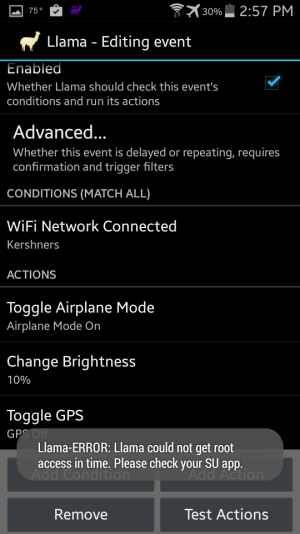

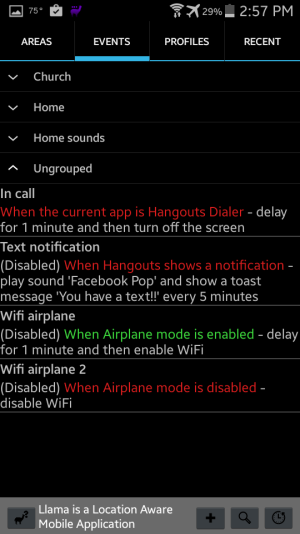

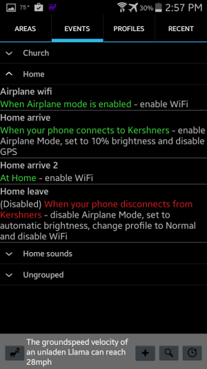

Ok so I've had Llama for a few weeks now and it's driving me crazy that I can't figure out how to do this:
The main reason I downloaded it was to save cell service while I'm at home. We moved to a new house and the cell service is 2-3 bars, compared to mostly 4 at our old place. I use wi-fi for my home calling and 3g while I'm out so I would like it to turn on airplane mode when home, then turn on wifi. Then when I leave, turn off airplane mode and turn wifi off. The only problem is when I leave, it doesn't know I'm leaving home because it's on airplane mode. So unless I manually turn it off, nothing happens. I've tried switching it to instead turn on and off when I disconnect from my wifi network but then when I get home and it connects to my network, then disconnects to go into airplane mode, and then the other option triggers because it thinks I'm leaving home again and it starts cycling. This is what I have right now:
It also often give me this error message:

It didn't work. :( I'm about to give up on Llama, it seems like almost everything I set up on it backfires. :/
...I've tried switching it to instead turn on and off when I disconnect from my wifi network but then when I get home and it connects to my network, then disconnects to go into airplane mode, and then the other option triggers because it thinks I'm leaving home again and it starts cycling.
You can exclude WiFi radio from being disabled by airplane mode.
Before toggling airplane mode, add an action:
Locale plugin > Secure Settings > Airplane Mode Radio (or something like that).
Here you can choose which radio devices airplane mode disables. Leave out WiFi from the list of the radios.
If you want, you can change back Airplane Mode radio once you turn Airplane Mode off.
Try also using Secure Settings to toggle airplane mode instead of letting Llama to do it.
I'm on a rooted S4 Mini, just installed Secure Settings and added it to my module thingie but I don't know if I'm supposed to do anything else to make it work right because I'm totally new at this rooting thing.
Make sure to install SuperSU from Play Store, which grant/deny root access to Llama, Secure settings, and other apps.
