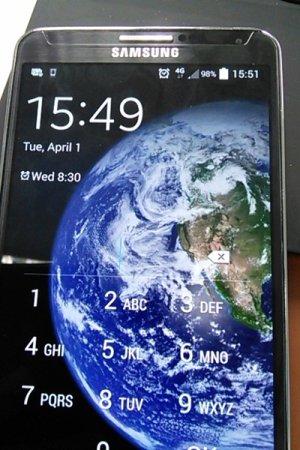

Hi Guys and Gals,
I've done a fair lengthy google search on and off over the last few days and I cant seem to find anyone that has the issue, but since the kitkat update my big lock screen clock doesnt update much or at all, sometimes its not visible at all. If I go to bed when I wake up and press the home button the screen lights up but the big clock will say 2350, but the taskbar clock will say 0730 for example.
If the screen goes off, and then I press the home button again the screen will have redrawn to show the correct time. Its a bug, it has a workaround, but its very frustrating.
In the previous minute I managed to get all 3 examples in three presses of the home button, clock 1 minute out, not showing at all and displaying the correct time - in that order.
Please help, I'm sure I cant be the only person that this is happening to?!
TIA.

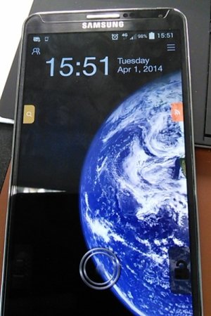

my workaround is to install a lockscreen app, so I can look at the accurate clock when needed. To access I have to swipe then enter the original pin lockscreen then unlock
Unfortunately this is like a double lock but better then a wrong clock!
I'm using "Start Lockscreen", free and pretty good.

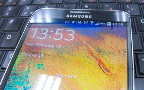

I was also having this same problem and I found a solution today.
The problem is the lock screen widgets (which you cannot use when you have a PIN secure lock anyway)
Go to Settings > My Device > Lock Screen > Lock Screen Widgets
The first choice you should have is Favorite Apps or Camera and it should be greyed out and set to ON.
You have to set that to off.
The only way I was able to do that was to change my screen lock to swipe, then I could go to lock screen widgets and turn favorite apps or camera to off and then set your screen lock with a pin again.
(My situation was even more complicated because to get my corporate email, I have to have a pin lock. So I uninstalled my corporate email. Did all the steps above and then reinstalled my corporate email)
Let me know if this does or does not work for anyone else.

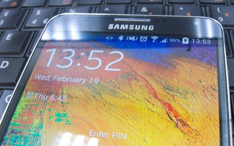

Hello,
Here is the solution to the Lock Screen Clock Not Updating.
In the Lock screen widgets settings there is an option for a "Dual clock". Set the Dual clock to "Off"
You can get there:
Settings/My Phone (tab)/Lock screen/Lock screen widgets/Dual clock
-Christopher K
