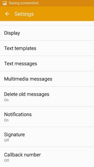

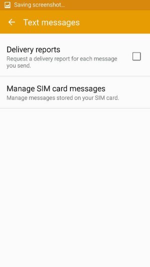

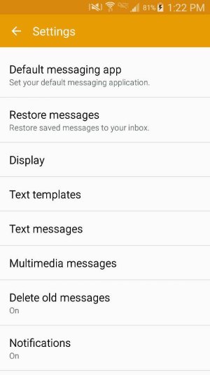

ive been using my verizon s4 on tmobile for the past two years.
everything worked data mms calls and text perfectly.
with the right apn. and the mobile network set to gsm
i just updated to lollipop this morning
everything works but sending texts
ive set the apn to tmobile so data works
just no out going texts
ive chatted with tmobile and i followed all there instructions
except once they told me to check the messaging center number under the setings in the messaging app.
its not there. no where on this lollipop update can i find it.
can anyone help ??
please im so upset about this
Here are screen shots of the menu in the messaging app

As donniedoomsday3 stated above, I too am using my VZW GS4 on T-Mobile and am having the same issues.
I just used Samsung Kies to update to the VZW Lollipop Update (OC1). I can Make/Receive phone calls, Receive Text/MMS Messages and I'm getting 4G LTE Data, but when creating or sending a Text/MMS it fails.
I have a Google Voice number and I'm currently using it in Hangouts to send Text/MMS as a temporary workaround.
If anybody had this issue or any advice it would be greatly appreciated.

What I did find is a lead on "messaging center" for people who are having issues with individual texts. The info I found was for another carrier, so I'm not using their instructions because they would have a different messaging center number. I would love to hear more from other people - if they know how to update my Verizon "messaging center" since I don't have that option on my G2.

Follow up: I got hung up again with a text in Messaging app. So I tried Hangouts. NO hangup on individual SMS text in Hangouts. So I went back into Messaging app and the Messaging text is still "sending"... but the Hangouts text is received in the Messaging app. Two (2) hours later, the text is still stuck "sending" in Messaging app. Changed the default SMS app to Hangouts. Problem solved.
