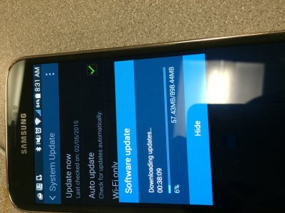

my phone is att and when I turned on my wifi this morning it seems to shows device manager is downloading software. Is this the update you'll are talking about. did anyone else's phone just start updating
by its self? I have no idea what the download is, doesn't say. how long will it take?
