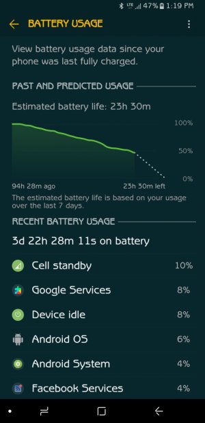

I've been leaving my S9+ sitting here with light usage every day to see how long I can go on stanby. I have the US unlocked version on T-Mobile. I should get about 6 days standby.
I had the same results last year with a US unlocked S8+.

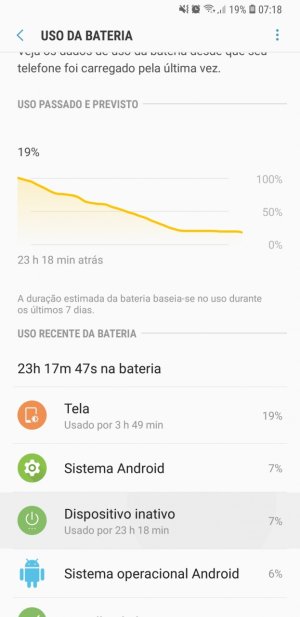

Hey man, as I said, I did a new factory reset. I just lost 3% this time overnight. Still trying to figure out what was draining my battery, since I don't have almost anything installed and disable every bloatware I could. I also removed my SDcard, I read somewhere on XDA Delvelopers that a malfunctioning card can give this issues. Especially if you install the apps or use it for big files storage. This is what I got now, is it normal right?
What do you mean by light usage? I mean, what apps do you use and how often to get those results?
With 3 hours and 49 minutes of SOT and 19% of juice left is not bad. Maybe because of weak signal?
