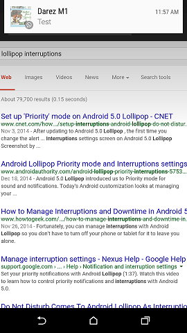

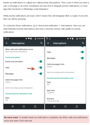

The new lollipop popup notifications from whatsapp are annoying. Anyone knows how to disable just the popup? Googling about it, looks like it can be disabled through the Priority Interruptions screen, but I can't find it on m8's settings:
Agreed.. the toaster popups are annoying.. I don't like information to be thrown at me.. I like to get an alert and read the message in my own time without it being shoved down my throat.. Its distracting, doesn't add value and, for the privacy concious of us, isn't discreet when you are using your phone in view of others.
