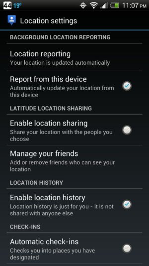

I would love to know what you/others are referring to, exactly...
It's right there, near the bottom...

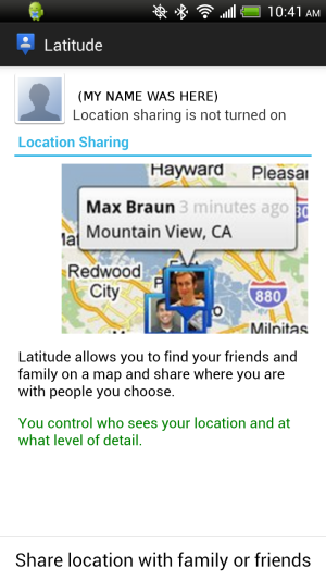

So I am not crazy afterall! When I select "settings" in Google Maps, then choose "Location settings", there are two consecutive popups saying "Loading...." and after a few seconds I get the following screen (see attachment) and there is nothing I can do on that screen, menu does nothing, there is nothing clickable at all. (Note, I removed my name from the screenshot)
FREAKY????

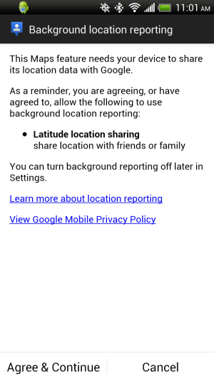

Wait, I can click on "Share location with family or friends", which takes me to a new screen that says "Background location reporting" (see attachment). There I can click on "Cancel", since I do not want to use Latitude nor Background location reporting. But it then kicks me back to the map. When I go into settings -> location settings again, I just takes me right back to the "Latitude" menu again.
If I AGREE to continue, *THEN* I can get into the menu that you are all talking about, and turn it all off again. Very confusing.
I am going to guess that what I said originally is accurate- if you enabled Google [Spy] Now (which I did not) then it will automatically also enable Latitude and turn on background reporting. If you never enabled "Now", then you would see the screens I did.
