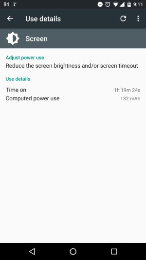

Battery seems to be doing better now after I installed the April update yesterday. So far I'm sitting at 60% with 2 hours of SoT and heavy usage.

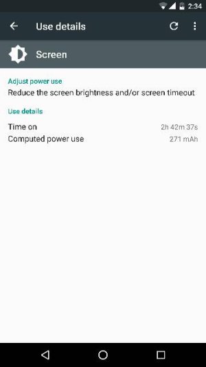

So far when it comes to battery life after the April Security Update and giving it a few days I've experienced a return to pre March Security Update battery life and in some cases better? Probably a placebo effect lol but I've been getting 2:30-50 or so around 45-55% battery percentage with a finale of 4:30-5+ around 5% depending on usage of course but I don't really game much
