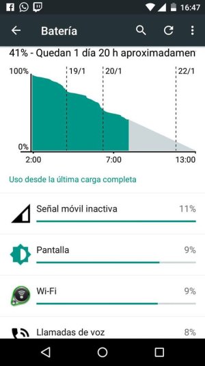

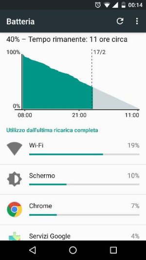

After installing the Marshmallow update on my Moto G 2015, like many others I started to see increased battery drain from WiFi via Battery Usage monitor. I wasnt clear if it was a reporting bug or if it was having an impact on battery performance....nevertheless it was annoying to see it at the top at 18 to 25%.
So I followed some suggestion to access the WiFi settings then Advanced to ensure keep wifi during sleep was set to only when plugged in.
Then accessed Back up & reset settings and reset netork settings. While this means I had to reenter wifi password and bluetooth devices, it fixed the problem.
