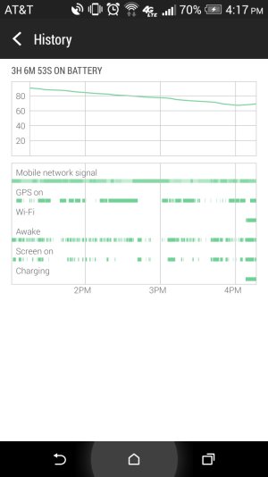

I was in Vegas over the weekend, and it seemed to be even worse than home in LA. As you'll see from the attached photo, GPS remained on a lot, especially during times when my cell signal was weaker. I still really believe this GPS issue has something to do with weak cell service.
In a way it does have to do with weak service. Every time your phone loses and re-acquires a signal, the GPS turns on. I now also noticed it's flashing for few seconds every time I get a phone call. The power drain at times is grater then the charger can provide. I had my phone plugged in and using it to browse the Internet and the battery was discharging. I think I am going to back everything up, go to AT&T and demand a replacement.
Another way the GPS issue is related to poor cell phone service is that they're both symptoms of the same situation. If you're deep in some concrete jungle like Vegas, you're not going to have great cell signal, and a GPS satellite isn't going to be able to find you to get a fix. My office building has both issues, so my only options while I'm at work are to put my phone in airplane mode or just leave it charging all day.
