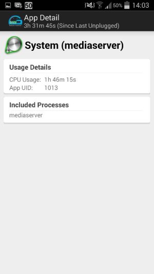

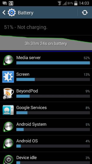

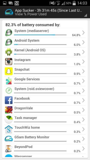

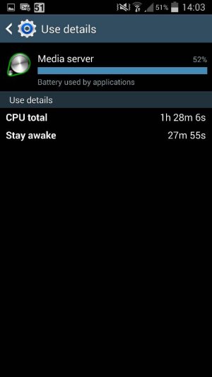

Hi, my galaxy s4 uses a huge amount of battery on mediaserver. I don't know what it does, and i can't figure it out. I tries to disable push notifications a couple of weeks ago, but that only helped for a couple of days. When i use it very easy, like listening to music or an already downloades podcast, it can use up to 30 percent in one hour. Before the mediaserver battery drain started i could almost go the whole day with about the same loss in battery.
Screenshots of the battery in settings and the app gsam.
