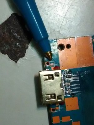

Ok now in order to mess in the recovery mode(what ever its call) hold reset n power botton as you turn on the tablet when you there you'll need volume buttons to go up and down if you open up your hiteker tablet and you mess with the motherboard the volume buttons are next to the HDMI plug-in, ull need to scratch the surface in order for the volume buttons to work as long as it makes contact with ground it'll shift up and down doing a factory reset does not delete the factories administrator password Instead it will only delete the password that you put also back to your recovery settings theyll be a update ADP or something well when you're there you need to learn about ROMs files I believe that's the way of getting the administrator password through there I will be trying to send a picture if I can of what to do and where to solder im currently in prison tryng to unlock this but all computers here are administrative password locked so i cant do much in here i by mehtore. If there is any one with some knowledge on how to go about this pleas help. Where the point of pen is pointing is litrly where the volume button is just scratcth surface so u can make it function as long as u make contact to another metal,copper..etc..
