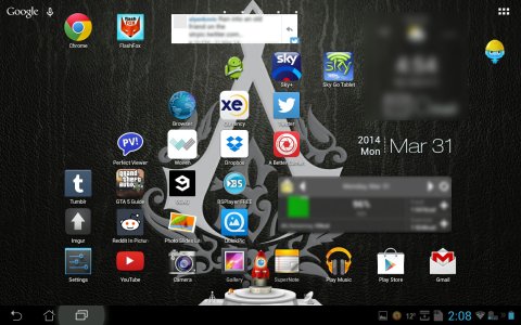

i just turned on my Asus transformer and i now have some stupid alien thing that is blue and has a yellow hat sticking out the side of my screen, that with u hold down on it brings a rocket up at the bottom of the screen. what is it and how do i get rid of it. please see image attached
i have scanned my pad , with AVG , avast and norton. nothing says any problems

Re: Memory optimizer with alien and rocket
Welcome to Android Central! It has to be related to an app that you installed. If it just started, you could try uninstalling your most recently installed apps and see if it goes away. Hopefully, someone else on the forums will recognize the icon.

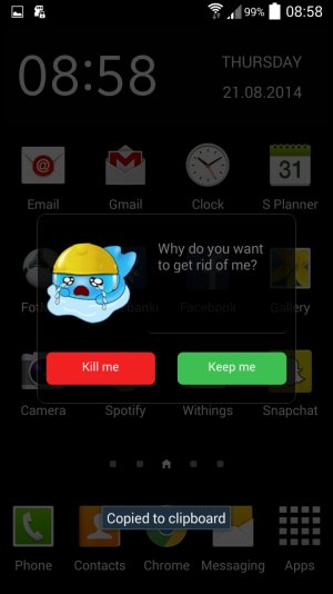

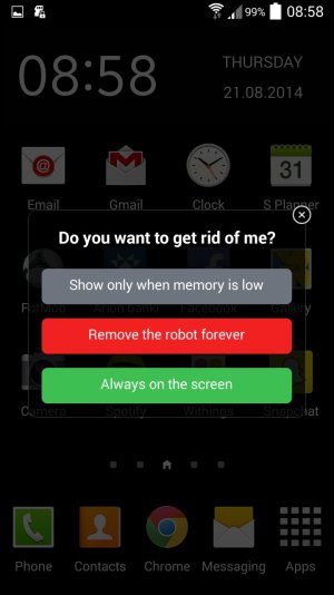

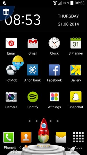

I'm attaching a screenshot now of this damn thing ... if I drag the blue guy to the recycle bin on the top ...
it gives you the option to "kill him" ... I do that ... but soon as I restart my phone, it comes back!!!! below are the 3 screenshots step-by-step
Huhhh, I can't believe this!
I uninstalled the NQ Android Booster and guess what ... the blue dude with the yellow hat is now GONE after restart ...
I'm VERY disapointed in NQ Android Booster to install this kind of **** bloatware along their product, which is by the way excellent and I've used it throughout the years!
But OK ... problem solved and I'll leave the NQ Android Booster for good because of this,
