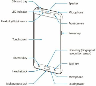

mustang7757 Admin Moderator Moderator Feb 6, 2017 99,145 15,858 113 Apr 19, 2020 #2 Hi, you made sure the microphone and speakers are clean ?
mustang7757 Admin Moderator Moderator Feb 6, 2017 99,145 15,858 113 Apr 19, 2020 #3 Here's where your microphone are and loud speaker and speaker
B. Diddy Senior Ambassador Moderator Mar 9, 2012 169,745 11,167 113 Apr 19, 2020 #4 Welcome to Android Central! The speakerphone most likely uses the secondary mic at the top of the phone, so make sure that opening isn't blocked by anything, like a poorly fitting case, or clogged by lint.
