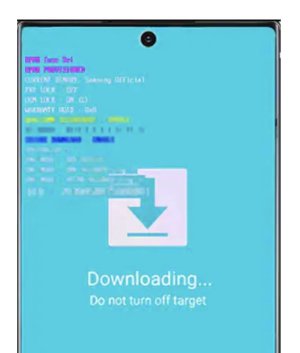

According to that I'm doing it correctly, I can't get volume up and power to do anything. However, I used the "USB" method which went straight to download mode which had different things on the screen such as carrier, warranty, etc. Tried it again and same exact error came up in Odin. That website says the usb mode is the only way to get into "unlocked bootloader" so perhaps that is why the last few successful time (according to Odin) didn't take? Suppose I could try the unlocked firmware again with this method and see if it works.
If you don't see this , your not in download mode .pending-1595219959-Screenshot_20200713-003830~2.jpeg
Yep, thats what i've got using the USB method. It looks exactly the same using the Vol down and power except the text at the top left isnt there. Still "Failed! SHA256 is invalid".

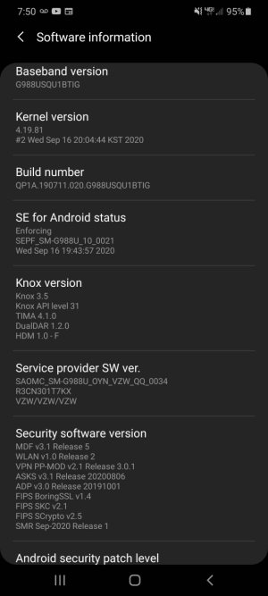

SO AS FAR I CAN UNDERSTAND FOR What i read I'm have a Verizon S20 ultra with VZN CSC carrier Screenshot_20200930-075032_Settings.jpg phone.
I put a T-Mobile sim on it and works, the only thing don't show is the network mode Choose 5G/LTE/3G/2G (auto connect), If i flash with the previous instructions using T-Mobile firmware I can have the carrier features and the phone will work as well.?
SO AS FAR I CAN UNDERSTAND FOR What i read I'm have a Verizon S20 ultra with VZN CSC carrier View attachment 327186 phone.
It should work , but a t-mobile sim should of configured the device if its unlocked, but no harm flashing to t-mobile firmware.
