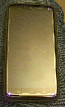

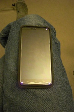

Received my Mime today...
I'm sorry to report that, despite the positive reviews and the spectacular packaging, it was terribly haloed and there were even a few spots near the center of the screen that it simply didn't adhere to the glass. I have sent a message to Mime via their Contact page requesting a refund. I'll be sure to report back on the quality of their customer service. Given their reputation (and again, that impressive packaging) I am expecting a quick and professional reply.
Very disappointed as it seemed quite solid in hand although I was surprised at the thickness (compared only to iVoler, the only other tempered glass I have personally dealt with so far).

I've edited my post to include pictures, but I'll say it again.. I'm going to go hunting up north in the big city for this VZW tempered glass on Monday. Just hoping I can find a retailer who actually carries/offers it. I know I can order online but I'm already going north and would like to just pick one up instead of waiting on the USPS yet again. I'm getting a little impatient which is unlike me normally lol
Your pictures show what I'm talking about. Notice at the bottom one sensor is covered while the other isn't. That alignment issue along with you positioning it just slightly too high messed it all up.

I'll admit that I'm not perfect, but those lower sensor lights are not evenly matched. The one on the left is slightly higher.. something I noticed during my iVoler escapades. Either way, the Mime was as centered as I could possibly get it, having used the camera as my main guide as well as some other previously posted pictures here.

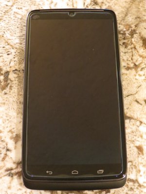

Yes I did and it installed mostly perfect. There are a couple spots where it just doesn't want to adhere along the edge, no matter how much I try to persuade it otherwise. It is also a tad on the short side, meaning it could certainly cover more of the upper part of the screen (as my one well-cut iVoler did). But other than that, it is a decent product that I'll keep on my Turbo until I come across a better one.

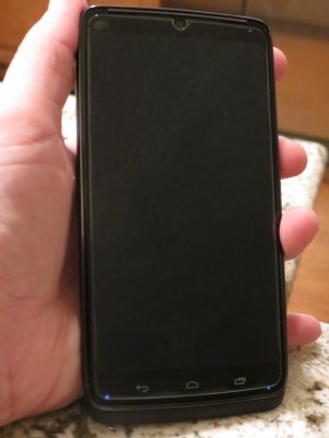

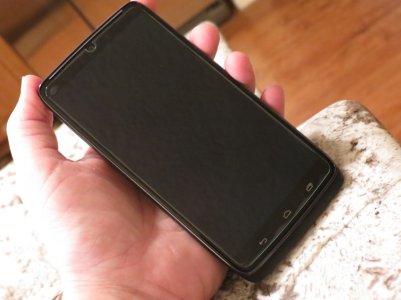

That being said, I think I got the side-to-side placement absolutely correct this time, yet there is still a slight halo all around still. Oh well - I will go ahead and leave it as is for now, until I hear of something.better. At least there is no dust.
I can't understand that. I don't have any of that halo effect on my phone or my sisters phone.
One thing to remember is since its not flexible a mess up on one side can ruin another side. Your installation is just as bad as iVoler was for me which makes no sense.

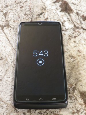

I ended up going to the Verizon store and showing the store manager the problem. She said they put those protectors on the phones all the time and do not have the problem with the failure to contact at the bottom. I had a spare unopened protector and asked her if she would put it on for me. She said she would and came out after a few minutes with an almost perfect installation.
She said two things that are very important:
1. Disregard the horizontal dotted line. Instead, get the vertical alignment correct by eye, starting from the top and matching up the cutouts where the glass exposes the front camera, etc.
2. Do not press on the protector during installation.

The horizontal line is fine but its not necessary. There is plenty of room on both top and bottom to move. The vertical has little wiggle room so I would agree with her. As for not pressing, I can't imagine this matters. But then again I use tape to make a hinge and it adheres itself. I only use pressure once its on to clear out any bubbles.
Glad she got it corrected for you!
