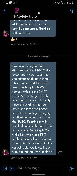

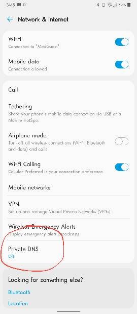

Pretty sure it's private dns. With it turned on, doesn't matter which dns, it doesn't work. Starts working again as soon as it's turned off. That's a huge network issue for T-Mobile
You don't have a option for automatic? Looked at mine and set to that , also if you turn WiFi calling off does it work? , I know Att had issue like that .
Yeah I have the option for automatic, and it works when it's set to that. But it defeats the purpose of a private dns. I have been using either adguard dns, or cloudflare ever since the feature was introduced in Android with no problems. But it definitely stops working as soon as I turn it on
It's possible that the stock message app doesn't play well with that ad guard.
