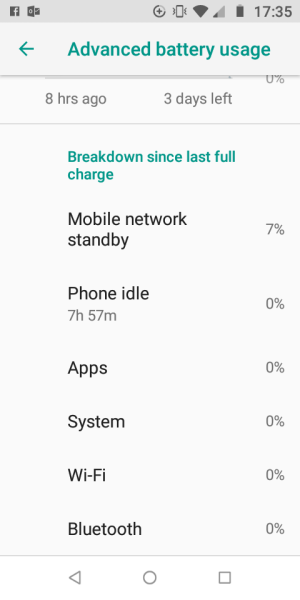

My new moto phone does this, Mobile Network standby drains the battery 1% per hour with everything off (mobile data can be on or off) . Only solution I have found is to use airplane mode when I dont need mobile signal
