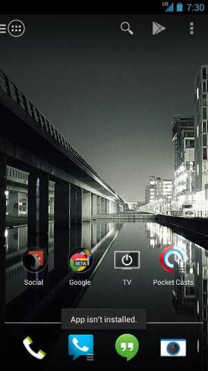

Using switch has brought me to a realization that I already had, and didn't know I had really. None of us really think about it and we shouldn't have to. An app is just an app. It's not a similar app or a different app, just itself. Normally this is crazy talk, but clearly the picture below disproves my lunacy.
Here's the thing: your dialer is an app. Your camera is an app. Your gallery is also an app. And guess what? Sense has it's own dialer, camera and gallery. GPe has it's own dialer, camera and gallery. They're not the same, though similar. Tapping a shortcut to the Sense version of any of those apps in GPe will give you a flash message like the one below. This is sort of jarring at first, but I'm really glad it happened. We take for granted that all of these things we use which are just preloaded functionality on a device work flawlessly. I never actually really acknowledged that the dialer was an app. I knew it was somewhere in my mind, but was never forced to think about it or face it. They run without a stutter or crash unless you have a fairly serious problem each and every time we call upon them. This made me happier than any feature, most likely.
Since Switch keeps your app settings between versions of the OS, when you create a shortcut to your dialer on your launcher/home screen, the link will be for the dialer that resides on that OS. Upon switching the link is still there for the nonexistant dialer, with the same application path that it had on your former version. The path DOES NOT EXIST on the GPe (in this example) for the sense dialer, thus I could not use the shortcut to make a call to get a tasty sandwich. This can all be overcome by using a folder with shortcuts to both dialers and cameras on my homescreen. If you use a link to gallery or any other segregated program, you'll need a folder too.
