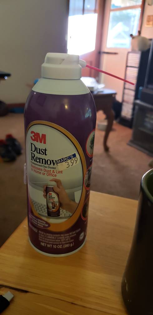

Try a couple shots of compressed air, something like this (see photo). That alone fixed my issue - when I had the issue, I couldn't even charge it with a cord.
I don't specifically have experience with liquid screen protectors, but doubt that's even the issue. Mine came about and I hadn't done anything to it - no screen protector, and it hadn't been anynwhere close to liquids for several days.

Just a quick note to say that using compressed air can in some cases drive debris etc up into the phone.
Depends how you use it. If you are just sitting there with your finger on the button loading a bunch of high compressed air, I could see that.
I believe the USB port is a sealed module so shouldn’t be driving any debris further so I don’t mind giving the USB port a good wack of air now and then.
The speaker ports are meshed I believe so that’s possible so I try not to go crazy when airing out the ports of lint or possible dust.
Don’t think I ever got the moisture message and I’m in south Florida keeping my phone in my pocket that can get pretty sweaty and damp in pocket when running around. But I have gotten slow charge message now and then and when I do, i feel it’s more possible residue on the connector in port that air can’t clean so I take a lens wipe wrapped over a hair pin and gently rub both sides of the connector clean and it goes away for a long time.
