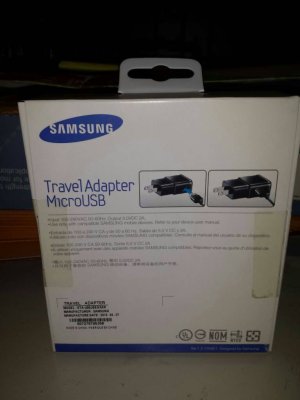

A little off topic, but how accurate is that app? I just purchased a factory replacement charger (2amp rating) from here and I'm only getting a 500ma reading with the supplied cable. I hook up my AT&T charger and I get the full 1900ma (2.1amp rating). I know it may seem like an odd question considering it should be something that "either works or it doesn't" but is there some kind of setting or something that I could be missing? I'm just kinda puzzled, unless this is a bad charger, which would make me think it wouldn't work at all. - Samsung Micro-USB 2A Travel Charger - Android Chargers & Cables

It should be accurate. I notice a slower charge with a different charger when the phone reports lower charging rates. Did you try swapping cables between chargers? Something somewhere is wrong.

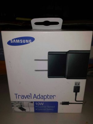

I got this charger which matches what came with the phone and my phone gets 1900mA with it. Is this the charger you got?
Sent from my AT&T Samsung Galaxy S4 using Tapatalk II
Well, mine looks to be a white version of the same thing. I've used the cable that came with the phone and the cable that came with the charger. Both cables will supply 1900ma when connected to the AT&T charger. Both will show as 500ma when connected to the Samsung charger. I've even tried different outlets and flipping the charger around.
I know it sounds dumb but try pushing the usb cable all the way into the usb port on the wall plug. I didn't have mine firmly seated twice and that was the problem. Otherwise I would say defective charger. What does the output on the charger say? It should be printed on the side of it.
I loaded the above mentioned app and it only says 0mA off the charger and 1mA on the charger.
Did you try different chargers? That's an odd reading. The developer is very responsive. He is implementing a couple changes I suggested, including having an option to have this app have a notification in the top bar when charging only.

It says it is a 2 amp charger. It is a factory replacement. If I pushed any harder on the cable I'm afraid something else would break.
It's got to be the charger then right? Something has to be wrong with it.
