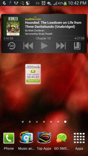

1900? Then this may be part of my problem. While on AC my device has been taking 7-9 hours to get a full charge. I've since downloaded that widget and currently getting only 300mA while plugged into my OEM charger. 1370922188214.jpg

The Samsung charger that came in the box? That is ridiculous. Something is wrong. Do you have other cables and wall adapters to test?
I've found mixed results with my variety of chargers and cables.
Stock charger and cable I get 1900
Samsung accessory 2amp charger and cable (identical to what the phone came with) 1900
HP Palm Pre charger and cable around 1060
HP Touchpad charger and cable 1900
Older yet identical looking Samsung cable with 2amp charger 1060 (!) and with 1amp charger only like 500mA
I threw the older Samsung cable away.
I'm getting the palm touchstone coil in the mail in a couple days and will report back on how the inductive charging rates are. I expect to get around a full 1amp.
With the stock charger the phone should charge fully in a little over an hour.
Thanks, David
Sent from my SAMSUNG-SGH-I337 using AC Forums mobile app
And by removing my usb extension cable I got up to 640mA.
Well, the extension could definitely have a negative effect. Are you use *both* the OEM charger *and* cord it came with?
The issue ended up being with my OEM usb micro cable. It was only putting about 420mA to the phone. After trying another cable with the charger it made all the difference in the world. It now charges in about two hours.
