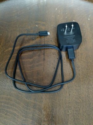

So I ordered the turbo charger when I ordered my phone from the Moto site in late September (Verizon). I received and email from Motorola yesterday that my charger had shipped, with an estimated delivery date of Oct. 21. Much to my surprise, my charger arrived this morning (Oct 15).
I'm not sure how much I'm going to use it. Conventional wisdom is that fast charging batteries reduces their capacity to hold a charge over time. Any thoughts on this?
