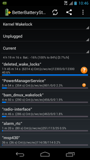

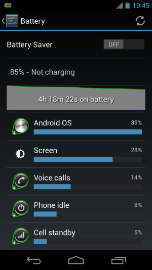

Screenshot_2013-09-04-10-46-46.pngScreenshot_2013-09-04-10-46-46.pngJust wondering if anyone knows what to make of these pics. I have no idea what the better battery stat is saying, but no matter what I do my android os is still so high. Thanks to all who take a look. Much appreciated.Screenshot_2013-09-04-10-45-46.png
Based on your signal strength and the fact you're stuck on 1x, your phone is struggling to maintain a signal. Yeah, your "Android OS" usage is going to be higher because of that fact. If this is at home, I'd look into another carrier. If this is at work, I'd keep that puppy on a charger!
How can you tell his signal strength? I don't see it in those pics. What is "stuck on 1x"? This could be why my Moto X has such a pathetic battery life.
1x is the Verizon equivalent of 2g, i.e. when you are in a spot that does not have 3g or LTE. Generally suggests you are in an area with weak coverage if you are only getting 1x.

Upper right hand corner. He has 1 bar. ;)
