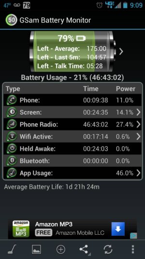

I don't know what happened to fix the drain issue. Got the update, cleaned cache.. 46 hours on 21% usage. This is what I paid for!

GMasonDragonDad,
Looks great.
Did you have data enabled the entire time? Do you have Google Now enabled? Location Services? Always Listening? Active Notifications?
Just would like to understand what your configuration was that gave you 0.5 % / hr drain.

I uses App Cache Cleaner to clear cache. I tried recovery mode way but could not figure it out. 4g data connected the entire time. Google now,,location services, and touch less controls were off. Active notify was on. I also changed to Dashclock on home screen. Again.. Not sure what fixed the issue. I just hope it continues this way! 72% at 60 hours. Amazing!

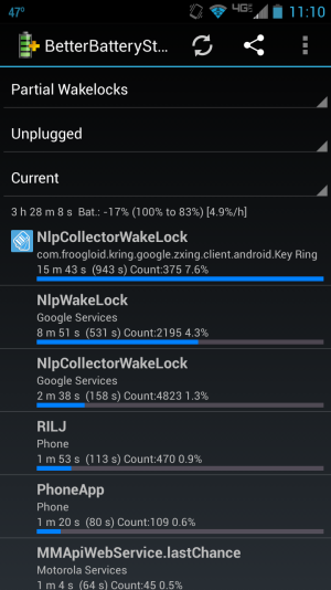

Most of my drain comes from Android OS as well. With better battery stats most of the Partial Kernel wakelocks come from NLP also. Network Location Provider, I believe. I attribute it to Google Now and keeping my location settings and GPS on at all times. Google now is supposed to have low battery pings for location, but it does seem to be very active.
Why is key ring giving you location wake locks?

Good freakin point. I didn't even notice that... Usually regular NLP Collector is the biggest wakelock. I may just switch to Google Wallet and ditch keyring if I can't figure out how to reduce its wakelocks.
I use keyring and it doesn't give me any wakelocks. I have notifications disabled within the app
Sent from my XT1080 using Tapatalk 2
I tried restricting background data through data manager and it's still giving me wakelocks. Going to try disabling notifications, but I've never gotten any noticeable notifications from the app.
