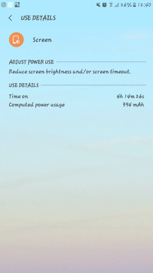

On the Battery Usage screen you shared, tap the Screen listing.
This? I had to charge it again last night.
4 hours of screen time isn't all that bad for a phone, assuming normal intermittent usage throughout the day. Was it a lot better before?
