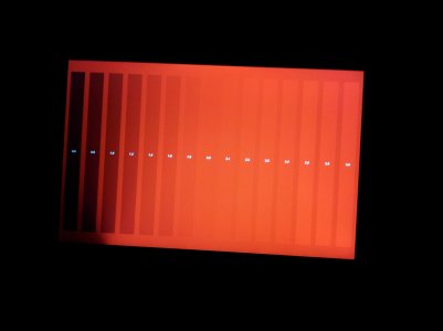

Any chance it was like this? I noticed this darker area, although it's not always like this. Idk either i should return it or keep using and hope it's a software issue.
It is not as bad as it looks in this picture, but turns reading into quite an annoying task due to the brightness difference.
ps: Made all tests available on display tester - this pic is one of them- and no issues like dead pixels etc
