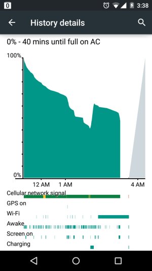

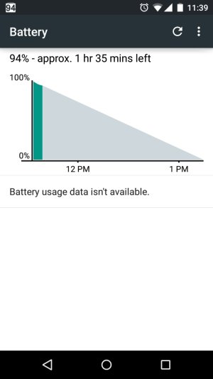

I'm having the same issue. Shut downs at 60% of remaining battery.
Cleared the cache but through Wi-Fi, battery is getting drained so quickly.
