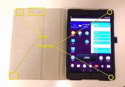

I have a different brand case and made this graphic for a different thread showing what activated the sleep/wake function. There is a metal bar in the cover that triggers it when it gets close to the screen between the camera and light sensor.

Thanks for the image. I'm stumped. Even after a factory reset it doesn't sleep. So either the case or the tablet itself is defective. Returning the case is almost not worth it being how inexpensive it was. It was 99 cents when I bought it, and it's frustrating not knowing if it is the tablet or the case. Maybe in a week or so a local retailer will sell a case for it that I can try before I buy.
