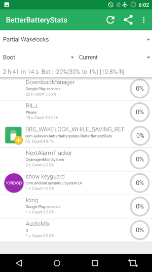

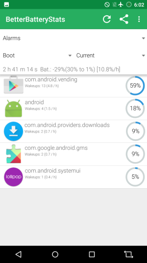

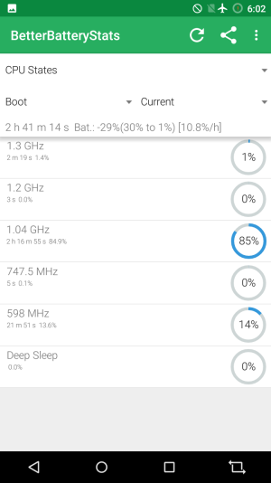

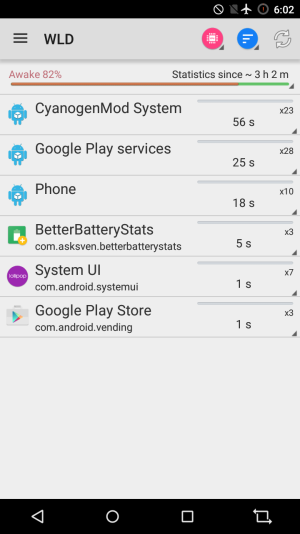

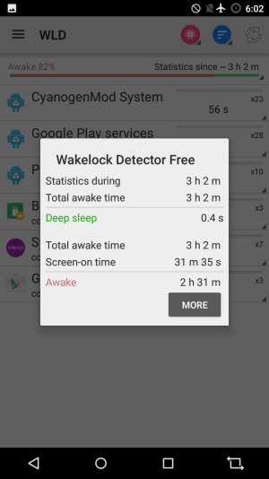

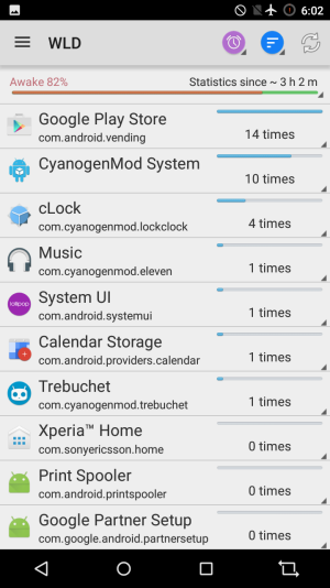

BetterBatteryStats and Wakelock Detector don't report any "abusive wakelocks". Instead the CPU is locked at the middle frequencie (1,02GHz with ALL cores turned ON) when it goes to "sleep".

Screenshot_2016-02-09-18-02-23.pngScreenshot_2016-02-09-18-02-26.pngScreenshot_2016-02-09-18-02-33.pngScreenshot_2016-02-09-18-02-52.pngScreenshot_2016-02-09-18-03-00.pngScreenshot_2016-02-09-18-02-48.png
As you can see in the screenshots, the CPU is locked in 1,04GHz when the screen is OFF.
