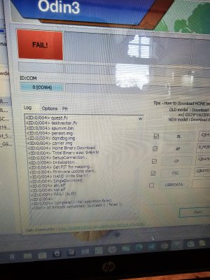

It happened again , says Fail 😫 Idk what I'm doing wrong or if something is wrong this is the NEW Odin I downloaded

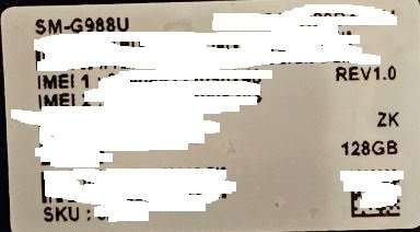

Positive! Here is a picture of the back of the phone

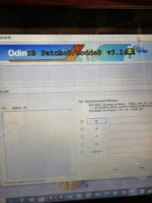

Yes ,I included pic above ... should I try the other Odin patch? What do you think could be the issue ?
That's what I'm trying figure out
We don't know your exact model number because you can't get in the device.
So try Odin patch B .
If doesn't work you will need to try downloading model number sm-G988u1 with VZW CSC in Frija and repeat everything same.
Home CSC firmware in Odin slot CSC

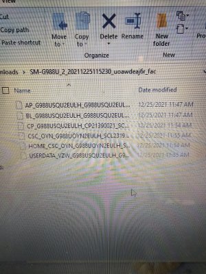

Okay will try all of this tomorrow ! Model # on back of the phone doesn't include a 1 at the end but I will try this! & yes I've been putting the HOME CSC in the firmware spot for CSC as well.
Thanks so much for your help this far , will reroute with you tomorrow, have a wonderful rest of the night !

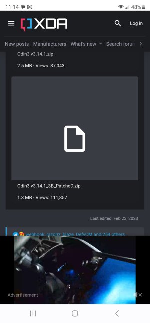

Is this the correct PATCH File for Odin ? Once you give me the ok I'll delete the other ODIN .

Ok downloading now. I will try it first without changing the model # in Frija-- If that doesn't work ill go and change the Model # in Frija. If I do change the Model # in Frija what else do I need to do after that? Will it automatically change everything in the other files?
So if sm-g988u doesn't work with patch when going to sm-g988u1 with VZW CSC it converts to unlock version , can down the road go back to the carrier version because these are all Samsung official firmware and not alternating the firmware like with Root or changing ROM from stock .
Ok Loaded ! Going to transfer the Frija to the correct slots and hope it works. I will change # if not . My question is though when u go change the model # in Frija will it automatically change the files in the second photo ?
