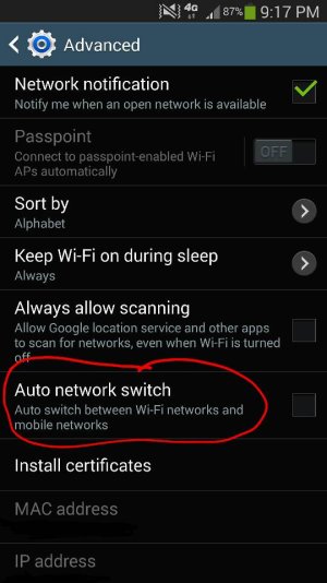

Check and see if "Auto network switch" is on within the advanced wifi settings.

Make sure you have a strong connection. Try improving it any way you can. Maybe unplug your router, let it reset itself? Like Almeuit said, try turning off Auto Network Switch.

I may have found my prblem. My Smart Network Switch was turned on. I cut it off and it hasn't dropped again. The other routers in the area was confusing the phone when it picked up the signal and was trying to connect? At any rate, I'm glad I figured it out without taking my phone somewhere.
