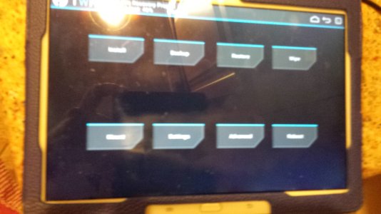

As for TWRP you seemed to have backed up to your internal storage, is it a possibility that you were looking in your external while you were trying to restore? You did say that you deleted the file in the Backup folder, since you did everything in recovery before a reboot, the backup file might have still showed up in a temp folder in cache partition somewhere. A good rule of thumb is to go to your file where you backed up and verify that the file is in place before you begin wiping anything, I'll even go into restore to be sure I can find it there and that the file is the appropriate size 4-6gb.
During first boot after wiping things in recovery, your system is rebuilding your partitions, system apps, and other system data, this information is pulled from folders within the system partition this process takes time. Another good rule of thumb, is to allow your device 5-10 mins to startup after you do anything in recovery. Even after the device loads the homescreen, I let it sit a few minutes to load other apps and what not, in the background. This is the time I usually reboot and walk away, otherwise the temptation is too great to fiddle with the device.
No , by the time I tried to do the restore, I had deleted the b/u from internal, and (thought) I had sucessfully did another b/u and properly saved it to external, who knows what malfunctioned there
Yeah, that would have been a good idea, but after the annoying time consuming ordeal of trying to find how to delete the b/u that took up all my available internal storage, and then doing one to external, I guess I neglected that logical step, live and learn ey?
The problem was the cache wipe produced an error, that I could not get out from, so after doing the FR, and the reboot, I only saw a partial screen begin, logo, blue circle, then blue circle stopped midway, and just saw SAMSUNG on the screen. I would have expected either a wait, or in progress message, to cue me to wait. So my thought was it was hung.
