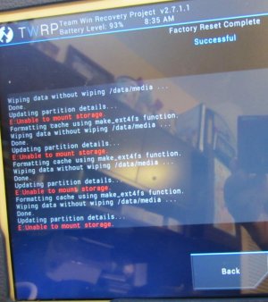

started the factory reset, seemed like it was starting but the screen said something about that E: /cache again. the bar on the bottom showed some animation, but not really like a progress bar moving. It did that for just a few mintues, then rebooted to that same, screen, the SAMSUNG then just hung.

ok just tried the FDR again, went a few seconds now, and I get this:
Should I hit BACK, then reboot, then just wait?

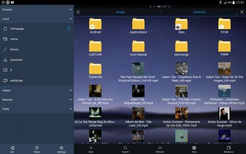

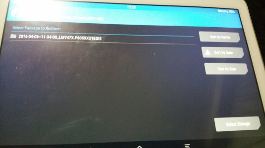

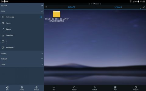

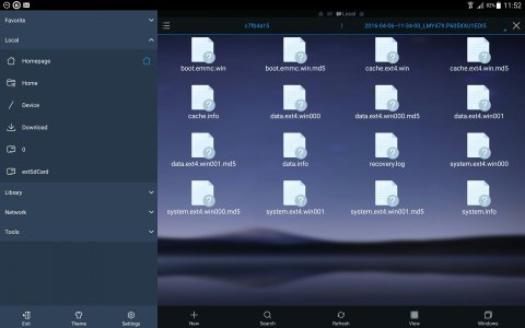

You had me worried there for a moment. I checked my twrp and restore does see the backup on the external sd card.
2016-04-06 09.53.19.jpg Unfortunately I am having the same difficulties get a readable shot of the restore option (overcast and raining, both flash and overhead lights renders poor image)

Got a picture of the twrp recovery screen View attachment 223621
Huh, so any guess why my restore did not see my b/u. Also why . My ESfile exp. Could not? In ES in the tools section there is root explorer, but when I go into it , its really just a task killer. I'm tempted to try another b/u to the card and see if I can see it. But at this point I'm afraid to even temp fate by going into twrp

So under the category of, we can never really leave well enough alone, can we? ;-) . I went back into twrp and did a new b/u and, this one does show up on my extSD AND I also can see it with ES file explorer. Who knows what happened before, maybe the tablet was so messed up it did not do the b/u correctly ?
