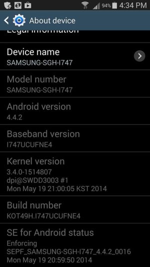

I have a Samsung Galaxy S3 AT&T and for about a year and a half always wanted to root it but had no idea how. I had an iPhone a while back and used to jailbreak it I became an expert at it. Rooting is not so easy compared at least with the problems I've been experiencing :'(
I started by watching hundreds of root videos and ended up rooting it with Odin and Kit Kat tar file im not sure of the specific file but I'm almost 100% it was my version 4.4.2 that I flashed.10719500_868074489872430_706365079_n.jpg
After I did this I downloaded the basics and tried to get TWRP but gooManager wasnt working for some reason.
I tried to flash the Cyanongen 11 onto my phone using the installer for the comp and on google play store and it worked up until the end I got the dead droid symbol for a bit and it finished downloading to show the "ROM may flash stock recover on boot. Fix?" error message and I selected no and "Root Access Possibly Lost Fix?" I also selected no. My phone booted with no custom rom still rooted and most of my apps are unresponsive and close randomly except facebook and youtube.
I decided I wanted to return it to stock rom and try again but when I downloaded the stock tar file and tried to flash it I got this10732133_868078886538657_763515336_o.jpg
I'm not sure what to do because I cant return it to stock rom, clockmod recovery has stopped working, and every video I watch about how to fix it is only making it worse.:mad:
If you have any idea what I can do or what I'm doing wrong let me know.:confused:
I'd rather just reboot my phone to the stock rom I don't even know if I want to continue messing with roms and rooted options until I do extensive research on it because I had close calls to potentially bricking my phone. Do you know why I got that error message on Odin or how to fix it?
