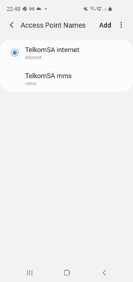

The APN settings are exactly the same as my other phone I'm currently using (Galaxy S8).
The only difference I can find in any of the settings is that the SM-G970F doesn't allow me to select Manual or Automatic Network selection as shown in the video above.
These screenshots were taken with the SM-G970F connected to wifi or not (shows the same).

I don't think it's a sim issue, I'm thinking a APN issue that needs to be tweaked.
TelekomSA seems to do strange things with their APN, but the following should work:
APN: Internet,mms
MCC: 655
MNC: 02
MMSC: http://mms.8ya.com:38090/was
MMS Proxy: 41.151.254.162
MMS Port: 8080
APN Type: default,supl,mms
APN Protocol: IPv4
APN Roaming protocol: IPv4
Anything not listed, just leave blank.
You have 0 bars showing in the screenshot. Have you looked at the indicator while experiencing this problem?
