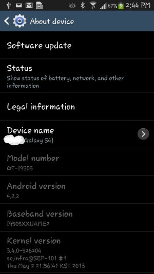

Hi I got an S4 passed onto moi.
Is there a way I can safely restore it to factory settings (just as officially from Samsung)?
I ask this because when I try to update software, this error shows "Your device has been modified. Software updates are not available".
I tried to find a quick fix, but very confused.
I read some stuff on here like Odin, Kies etc; and 'rooting'(is that the Android version of jailbreaking?)
I have no SD card mounted and my Device Status says Custom.
I already did Factory data reset via Settings
I would like a condensed version of steps on how I can restore my S4 to mint condition safely.

You have 4.2.2 installed, so it should be able to reset the knox counter/custom with trangle away app the paid version. That should theoretically allow you to receive updates if any are forthcoming. But as golfdriver asks, what do want to do?

The last part is because it has been rooted. The device can see the root files that are added and stop the OTA update.

The 4.4.x refers to the os build number. You currently on 4.2.2 from your Screenshot.
The custom waring can be removed using an app called" triangle away' which will not work if you upgrade to 4.4.? and then try to remove "custom"
