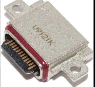

Sounds very much like an improperly installed charge port seal, from the description you've provided, not having seen the construction until I search for the S10 charging port itself. I've provided an image, does it (the ring) look like the sample seen here, or similar? As a guest, you cannot reply in the Ask A Question subforum, so we'd be grateful if you could share more information by registering.

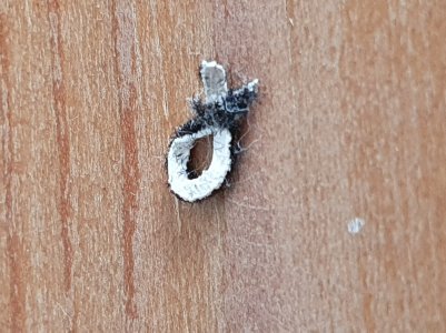

Please see attached photos. One shows the seal in situ (it was actually at the base of the port but I had pulled it up a bit to see what it was. Other photo shows actual seal/o-ring once out. Looks like it has ripped and white material is a rubber/black is a cloth type material.
I don't think it could have got there accidentally as you would've had to force it down into base of port.

Wow, I'm not quite sure what that is, actually. Maybe something got picked up in a pocket, or on the end of the charger. It definitely doesn't look like an electronics-grade seal seen on the port I showed above. The images seem pretty conclusive in that department.
If it charged fine initially, and charges fine now, after you removed this piece of floo, I'd tend to think it was something that accidentally got picked up and shoved in by the plug, unless someone has a better idea of what it is...
I think you may be right - can't fir the life of me work out what it was or where it came from. ]Never had anything like it before in any phone I've had though !! Phone is charging normally so possibly put it down to bad luck.
